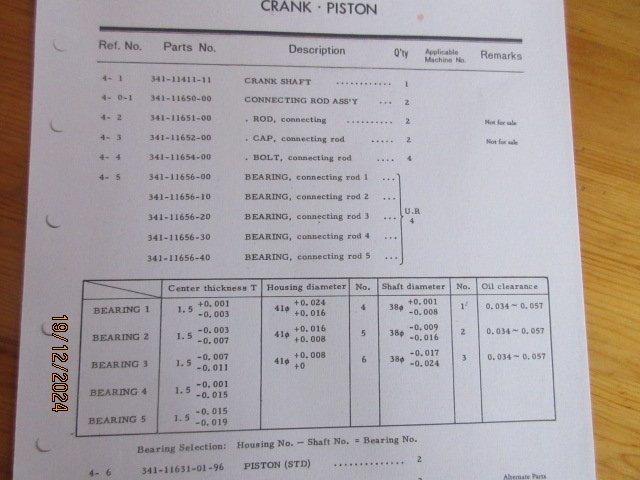

341-11656-20 (3) connecting rod

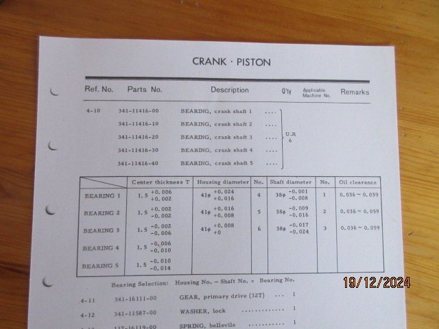

341-11416-20 (3) crank shaft
regards Torsten

Hi Torsten, I need bearings for the crankshaft, 341-11416-xxx, do you know where to find them?
But I also need to investigate if I need to have the crankshaft journal reground. Do you know, if untersize bearing caps are available?

Hi Jorn,
part numbers and size
Regards Torsten
